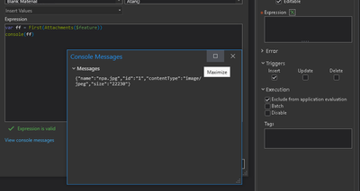

I am trying to add a column to a feature class that contains the ID of the attachment associated with each feature. The method I am using is the Arcade expression <First(Attachments($feature)).id>. However, I have encountered a problem – this method does not work in the version 3.0 of ArcGIS Pro that I am currently using. I've also tested it in version 3.1, and it seems to have the same issue.

Not sure what is going on, but I tested your code in 2.9.3, 3.1.3, and 3.2.1 and all seem to be working as expected.
if I put the ".id" at the end like you have, it will only return the id.

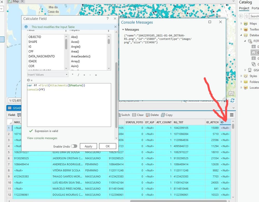

I have the same output when i just click to view console messages, seems fine. BUT, when i run just <First(Attachments($feature)).id>, it return only null. You can see the variable ID_ATTCH which i got it through version 3.2, and the variable ID returning null in version 3.0, but it shows correctly at console messages as well.WhatsApp Image 2024-01-23 at 16.01.29.jpeg
