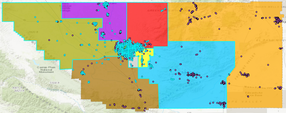

I also selected one of the districts and then tried doing a select by location on the points for the selected district.  By comparing the results to what I got in ArcMap, I think it selected all the right points, but for some reason, the highlights are all over the place.  It's really odd, because when I tell it to zoom to the selection, it zooms in to the selected district, but it doesn't show any of the points as being highlighted anymore.

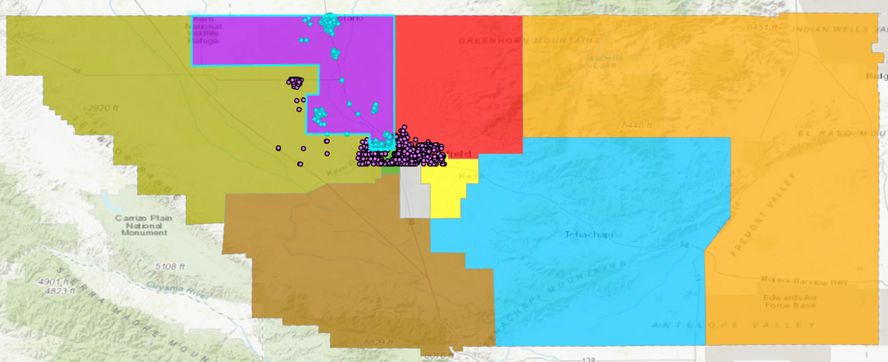

As you suggested, I selected some of the points and exported them.  I selected a rectangle on the map, and the highlights were all over the place again.
Selection highlights are scattered even though I selected with a rectangleSelection highlights are scattered even though I selected with a rectangle

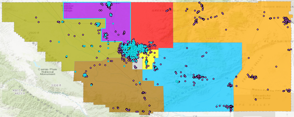

However, when I exported them into the project geodatabase, all the points in the resulting feature class were within the rectangle I drew.  And when I selected by location from my export, the highlights also showed up properly.
The points exported were all within the rectangle I drew, and the selection highlighted properlyThe points exported were all within the rectangle I drew, and the selection highlighted properly
