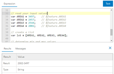

Have a look at the example below. It consists of 3 functions ("RemoveNulls", "MinOK" and "MaxOK") and at the end a couple of lines of code to create the initial list from your attribute values. It will remove the empty values from the list and return a corrected list that allows you to use the Min and Max (and other) functions:
Function RemoveNulls(lst1) {
    // remove empty values from list
    var lst2 = [];
    for (var i in lst1) {
        if (!IsEmpty(lst1[i])) {
            lst2[Count(lst2)] = lst1[i];
    return lst2;
Function MinOK(lst1) {
    // return min from corrected list
    var lst2 = RemoveNulls(lst1);
    if (Count(lst2)>0) {
        return Min(lst2);
    } else {
        return Null;
Function MaxOK(lst1) {
    // return max from corrected list
        return Max(lst2);
    } else {
        return Null;
// read your input values
var AREA1 = 3;    // $feature.AREA1
var AREA2 = 7;    // $feature.AREA2
var AREA3 = null; // $feature.AREA3
var AREA4 = 2;    // $feature.AREA4
// create a list
var lst = [AREA1, AREA2, AREA3, AREA4];
// determine min and max values
var minval = MinOK(lst);
var maxval = MaxOK(lst);
// return result
return minval + "-" + maxval;

Can you share more information about how you implemented the expression? I just did a test with the values you shared in the image and it works as expected:
DianaWilson1
I see the mistake that I made, I fixed and it works! Thank you,

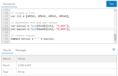

How to display the decimal places in this query. I used TEXT($feature.AREA1,'#,###'); but I just got NaN

Hi @DianaWilson1 ,
I assume you applied the text formatting to the original value and not to the resulting min and max value after processing the values. It is best to apply it on the lines below:
var minval = Text(MinOK(lst), "#,###");
var maxval = Text(MaxOK(lst), "#,###");
This will return the result with the thousands separator as shown below:
DianaWilson1
Thank you Alex! you are the best!
