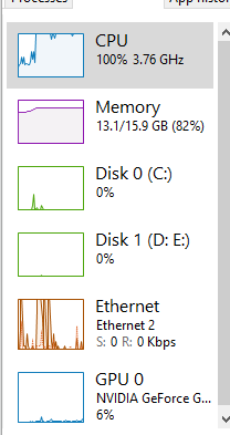

I'm using GTX 1070 as my GPU(the only graphic card I have on this computer), installed the required framework, CUDA and cuDNN. Under environments tab, I changed the Process Type to "GPU" and GPU ID is 0. However, when I hit "Run", my CPU usage goes directly to 100% whereas my GPU is doing nothing. From the documentation I'm guessing it couldn't find my GPU so it uses the CPU, but I'm very confused why this would happen.

Hi @YunfeiXie ,
Did you ever find out why the tool is not using GPU?
I'm having the same issue and am looking for a way to utilize GPU.
