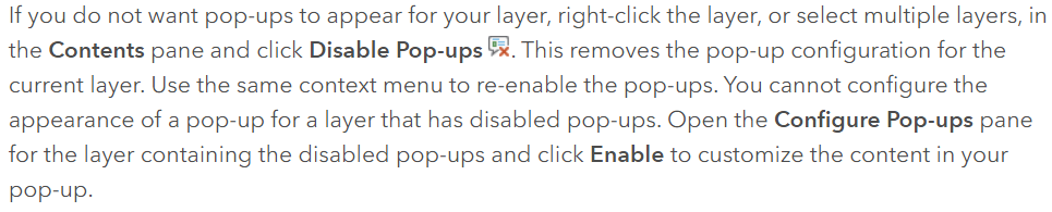

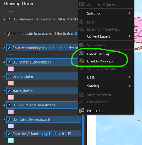

TomBole
Hi Jamal,
Please refer to the help topic: Pop-ups
You can do also this with multiple, selected layers.
Hope this helps,
Tom

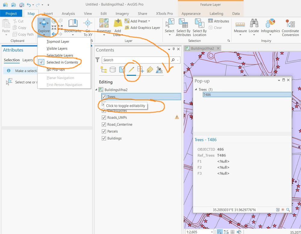

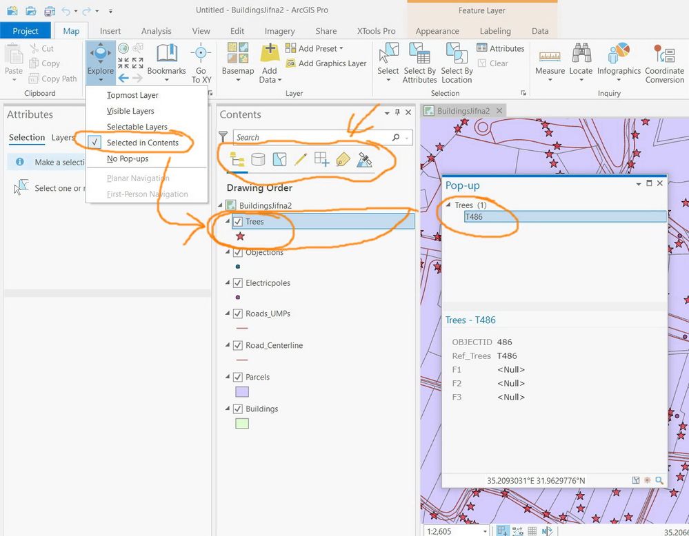

jcarlson
MVP Alum
Click the arrow below the "Explore" button.
There are a few ways you could set the popups to avoid a particular layer, see what works best for you! I like to set it to "Selected in Contents" myself.
- Josh Carlson
Kendall County GIS
JamalNUMAN
Legendary Contributor
Thanks Carlson.
Right. The “selected in content” option does the job but this appears to be a bit weak since it is dependent on the selection but not on checking\unchecking the layer that is required to participate in the “identify” like what we do for visibility\selectability\editability

TomBole
Hi Jamal,
Hope this helps,
Tom
