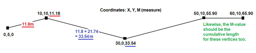

I have an Arcade calculation attribute rule that sets polyline M-values to the cumulative length of the line.
The script works as expected. But I'm still a novice, so I thought I'd ask: Can the script be improved?
Notes about the script:
- It works for both singlepart and multipart features.
