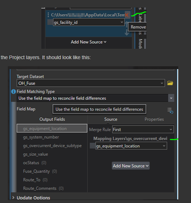

A couple of things I discovered as I transitioned to Pro was 1) not all the 'matching' fields matched up as expected, and 2) there is often a temporary path that seems to cause issues for me.
I had success by X-ing out the Source entry and re-mapping it by picking the layer from the dropdown, which seems like it's coming right from the TOC as one might expect.
I want to take a moment here and point out that speaking for myself, I find it confusing that the Inputs are on the right side of this dialog, and the Target is on the left. There are several changes to the interface that take some getting used to, but I digress.
This re-mapping had to be done all the way down the list to get the expected results. This was not required in Desktop and is quite a bit of extra work compared to the way it works in Desktop.
