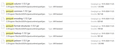

The CVE seems to concern only one specific library regarding Avro format, which doesn't seem present in the Pro install (see my listing below which slightly differs from yours but does not show a file name with 'avro'). These found modules are different ones, and as far as I can tell not involved in the CVE. I guess the affected module is called simply 'parquet-avro-<VERSION>.jar', but I didn't see the actual full filename listed in the CVE.

@MarcoBoeringa is correct and Tenable is providing a false positive. We do not provide the parquet-avro module. Tenable chooses to err on the side of false positives over false negatives.

I'd argue that there is a bug in your tooling.
This finding as against the parquet-avro module, which is not in the list of JARS the tool you've provided.
