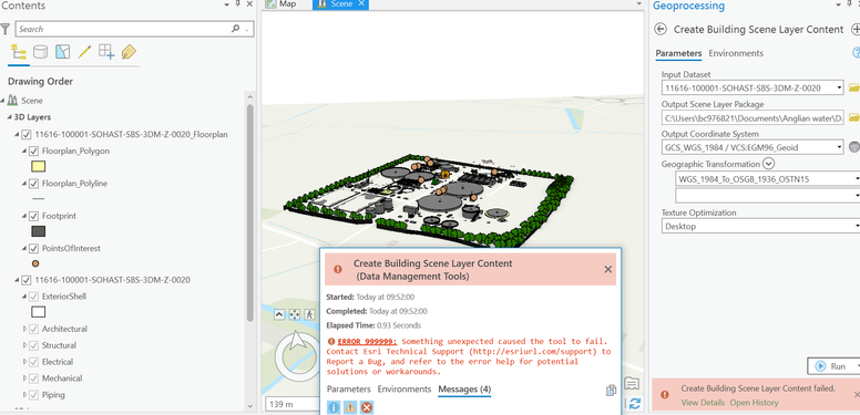

Hi there
I was wondering if anyone had come across this before (See below).
I am trying to bring a 3D revit model in a local scene (pulled from BIM) into ArcOnline. The base maps elevation is defined by using LIDAR data.
When I am trying to run the "Create Building Scene Layer Content" I get about 60% before running into a ERROR 999999. (Same error occures irrelevent of whether basemap in included or not)
If anyone had any insight or suggestions it would be amazing. Or if anyone needs more info let me know
All the best
-Ed
