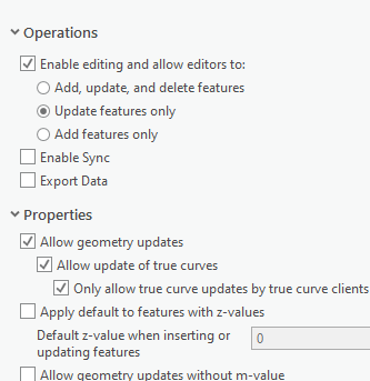

RobertBorchert
Honored Contributor
When you publish do you uncheck Add, update, and delete features

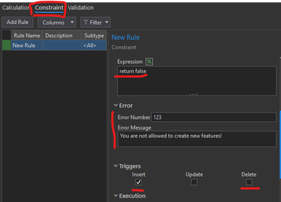

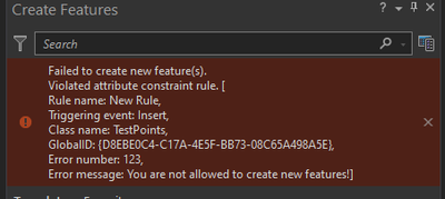

JohannesLindner
MVP Alum
This is a good use case for Attribute Rules, assuming you don't have to use the feature class in ArcMap (because fc's with Attribute Rules are incompatible with ArcMap).
In your case, it's really simple:
  • Add a Constraint Attribute Rule to your feature class
  • set trigger to only "Insert" (and "Delete", if your users aren't allowed to delete features
  • just return false (reject the edit)
Have a great day!
