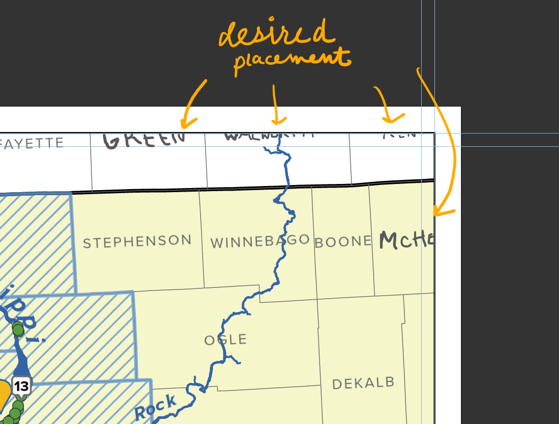

I'm wondering if there's a combination of settings that would effectively ignore the map frame as a boundary in placing labels. I have some counties that run off the page, and while I don't want them not labeled, I don't care to see the whole word. I'm just going for visual consistency. Therefore, I'm looking for the labels to be placed as if the map had no edge; as if this were a crop of an image.
However, my tooling around with the settings can't get this to happen. I have "Place label at fixed position within polygon" checked, as I want them all centered in the county. The labels at the edge of my data frame don't place whatsoever. Any ideas?

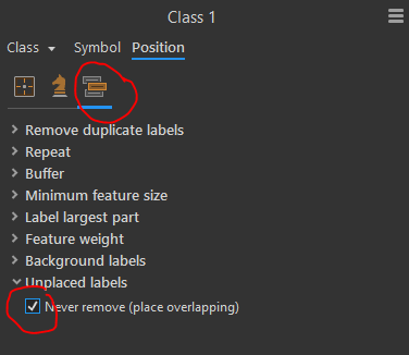

Hello,
Have you tried this?
Go to the Position tab within the label properties and check the box "Never remove (place overlapping)"  See pic below:

MVP Alum
Hello,

wayfaringrob
Honored Contributor
Oh, yeah that did it! That setting could be named a little more intuitively. Thanks!
