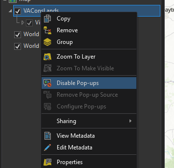

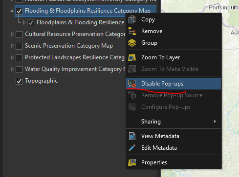

I have a webmap that displays several tiled layers, each of which has a popup enabled. The popups point to analogous feature service layers and they works great in ArcGIS Online. When I open the same webmap in Pro, nothing appears when I identify on those same tiled layers, even though when I right click on the layer in the Contents pane, it appears that the popups are enabled because I see a 'disable popup' option. Nothing seems to happen when I disable and re-enable them. I am on Pro version 2.9.0 Any ideas what could be happening?

Thanks for your quick reply. The data in the webmap are all hosted tiled services- is there a way to configure the popup in Pro on tiled layers to point to the attributes in a feature service? We were trying to avoid adding the feature service to Pro for display purposes because it's a monster dataset. When I right click on the tiled layer in the contents pane, 'Configure popups' remains grayed out.

I did- I created a new map, added a tile layer from ArcGIS Online, and when I click 'Enable Popup,' the option to configure it is grayed out.

I probably should have included this info earlier on but alas, the owner of the content is having the same issue. I'm also the administrator for our ArcGIS Online Org so I don't think it's a permissions thing unfortunately.
