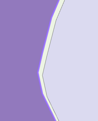

Example of gap it leaves when using Align Edge.

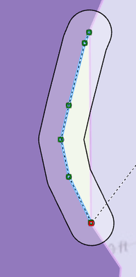

An example how I'm using Align Feature:

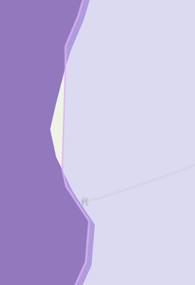

But it shifts it purple polygon and the light polygon to the right:
