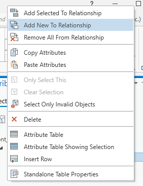

BerendVeldkamp
I know this is a very old thread, but since it took me forever to find out how this works, I'll post anyway.
To relate records from two tables that already have a relationship class defined, do this:
  1. Open the table view for both featureclasses / tables
  2. Select the records you want to relate
  3. On the Edit tab on the ribbon, click the Attributes button to open the Attributes pane. The top part contains the selected records.
  4. Expand either one of the records, so that the name of the relationship class becomes visible
  5. Right click on the relationship class, and select Add Selected to Relationship

AJR
From the attributes window you can add new records to the related table by right clicking and selecting "Add New to Relationship".  This will populate the new related table record with the parent record id value.

IanMackenzie
As of ArcGIS Pro 3.3.0 (and likely earlier versions as well), it is possible to add records on related tables via the Attributes editing tool (on Edit the ribbon).   Select an existing geometry feature on the parent feature layer or create a new feature, open the 'Attributes' tool, underneath the selected parent feature's attributes you will find the related table; right-click add new record.    Note, the related table needs to be in the map (you will see a warning exclamation mark symbol in the attribute tool if it is not).
