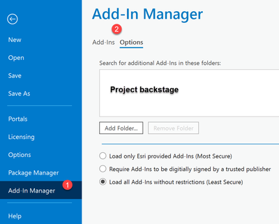

I don't use any, but guessing that you need to access them through the Project backstage in the AddIn section

Dan, I forgo to mention that I have already  added a folder through the Add-In Manager so that's not it.
