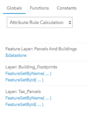

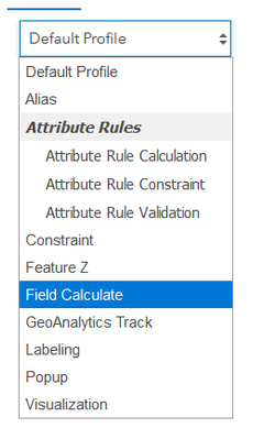

Switch the Profile, and the layers / functions available will update accordingly.
Attribute Rule Calculation, for instance, has two layers in the $datastore object.

Awesome. Thanks!
