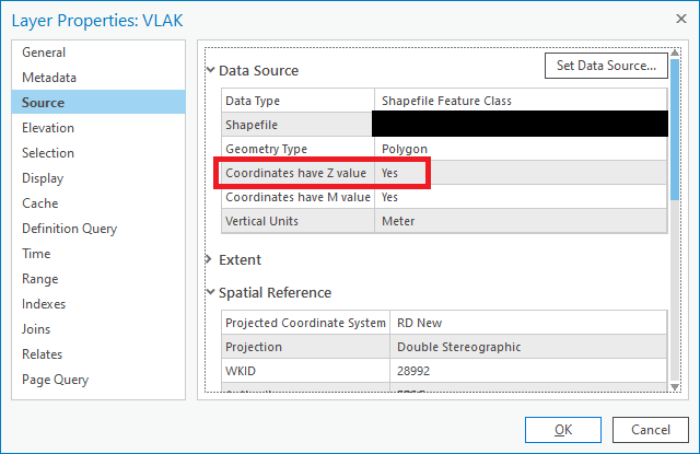

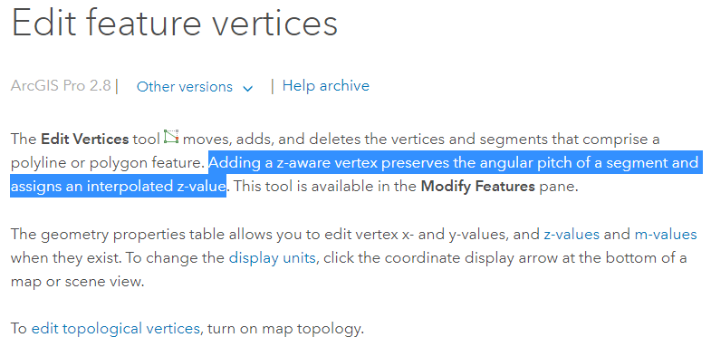

The problem is that when I add the vertex with Edit Vertices -> Add vertex, the newly created vertex will be at z = 0 m. I want it to be interpolated using the Z of the nearest vertices. I believe this is the intended behaviour of ESRI:

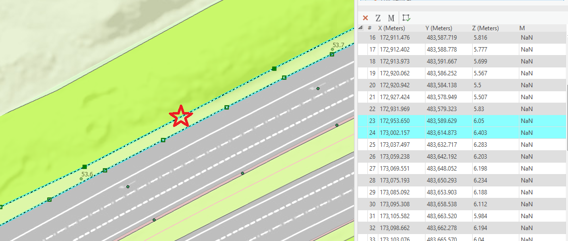

This is my original polygon (the format is shapefile by the way):
I want to add a vertex here:

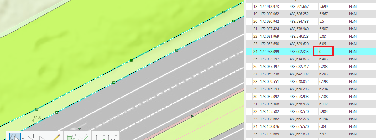

And I get the vertex with z = 0m, instead of an interpolation of its neighbours:
