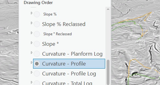

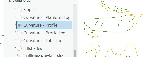

I'm using ArcGIS Pro 3.6 and have a custom DEM and a derived slope raster as well.  My workflow is as follows:
1. Right click Ground under the Elevation Surfaces item and select "Add elevation source layer" and navigate to the DEM via the "Add Elevation Source Layer".
2. Click OK.
3.  Turn off the WorldElevation3D/Terrain3D layer under Ground.
4.  Turn off the Custom DEM in the 2D Layers group.
5.  My derived slope raster looks fine with no Layer Properties changes at all.  See image below.Slope_Image1.jpgSlope_Image2.jpg
