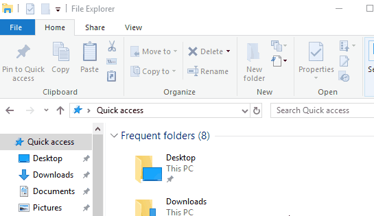

If you don't have admin rights to your computer, be aware that folders some folders (like c:\users....\Apps ) can be hidden

I had the same install error on a Windows Server 2016, but it was fixed by using the above mentioned guide.
I have admin rights on the system and had to enabled "show-hidden-files" in Windows to delete all the leftovers from previous Pro installations.
