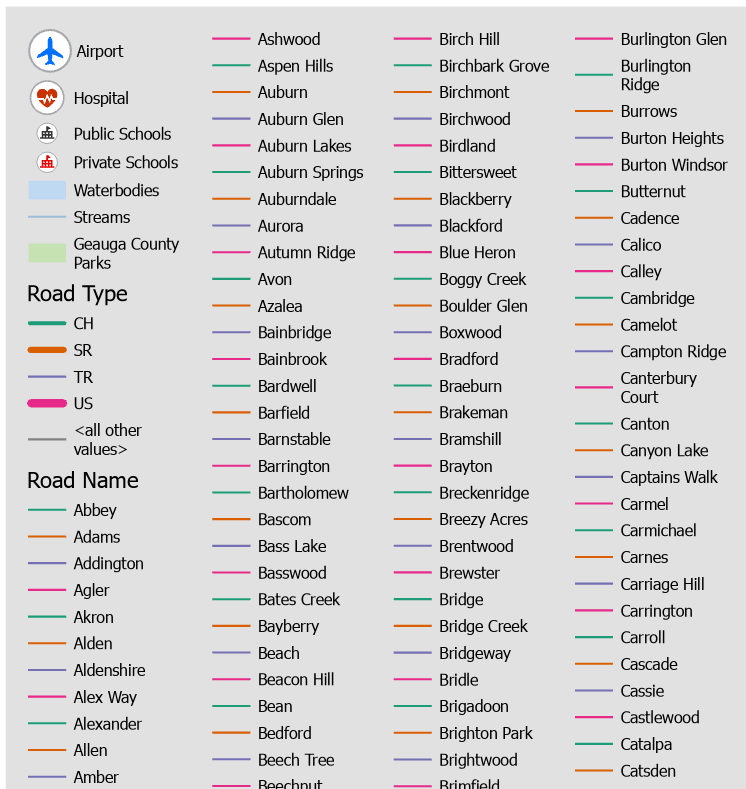

 My legend has road names, but I don't know how combine that with the road suffix and road number. I also don't know how to add a border that acts like a grid or how to assign grid numbers to the the roads. Finally, is there a way to wrap the legend around the top of the county? Below is my current legend.

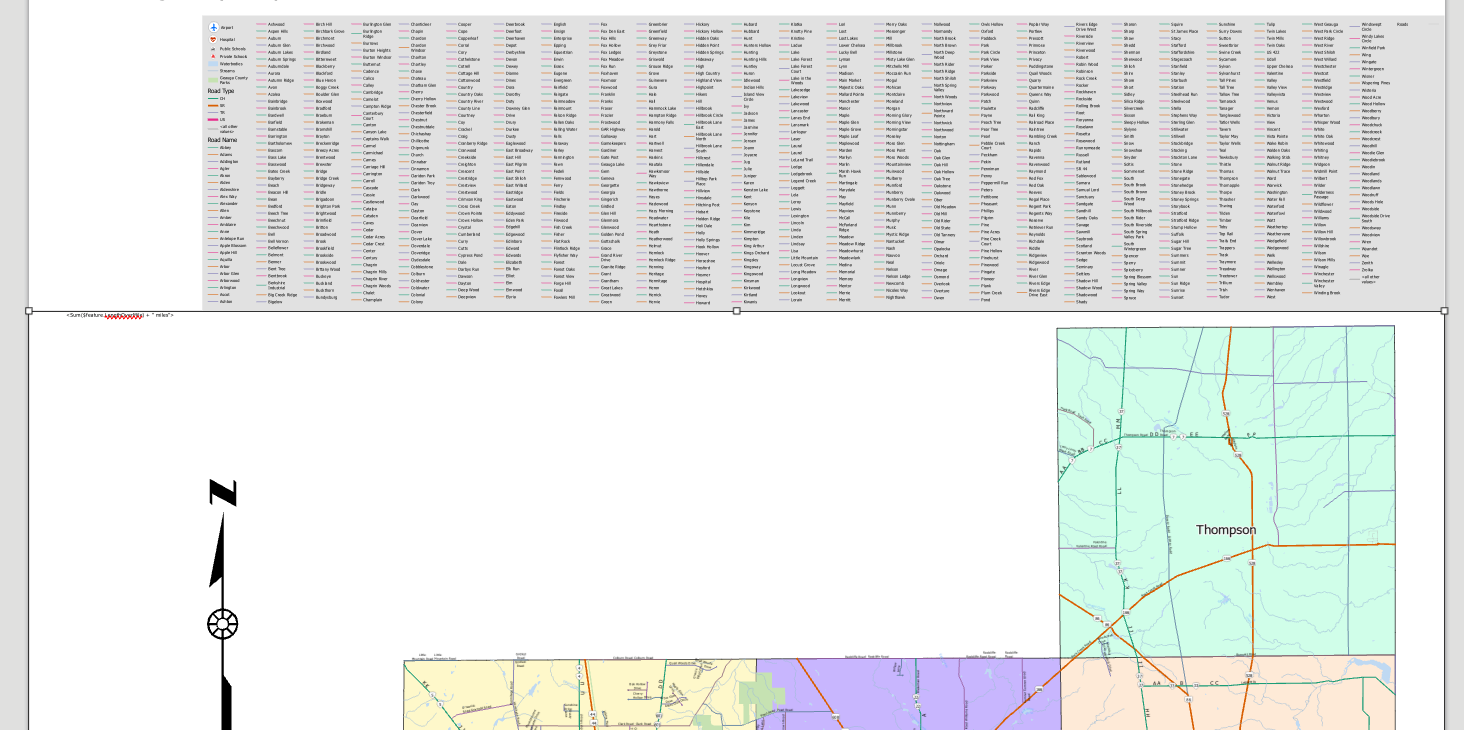

ThomasGoodridge
Apparently layout view has its own grid in the Insert tab, under Map Frames, click the Grid Icon
