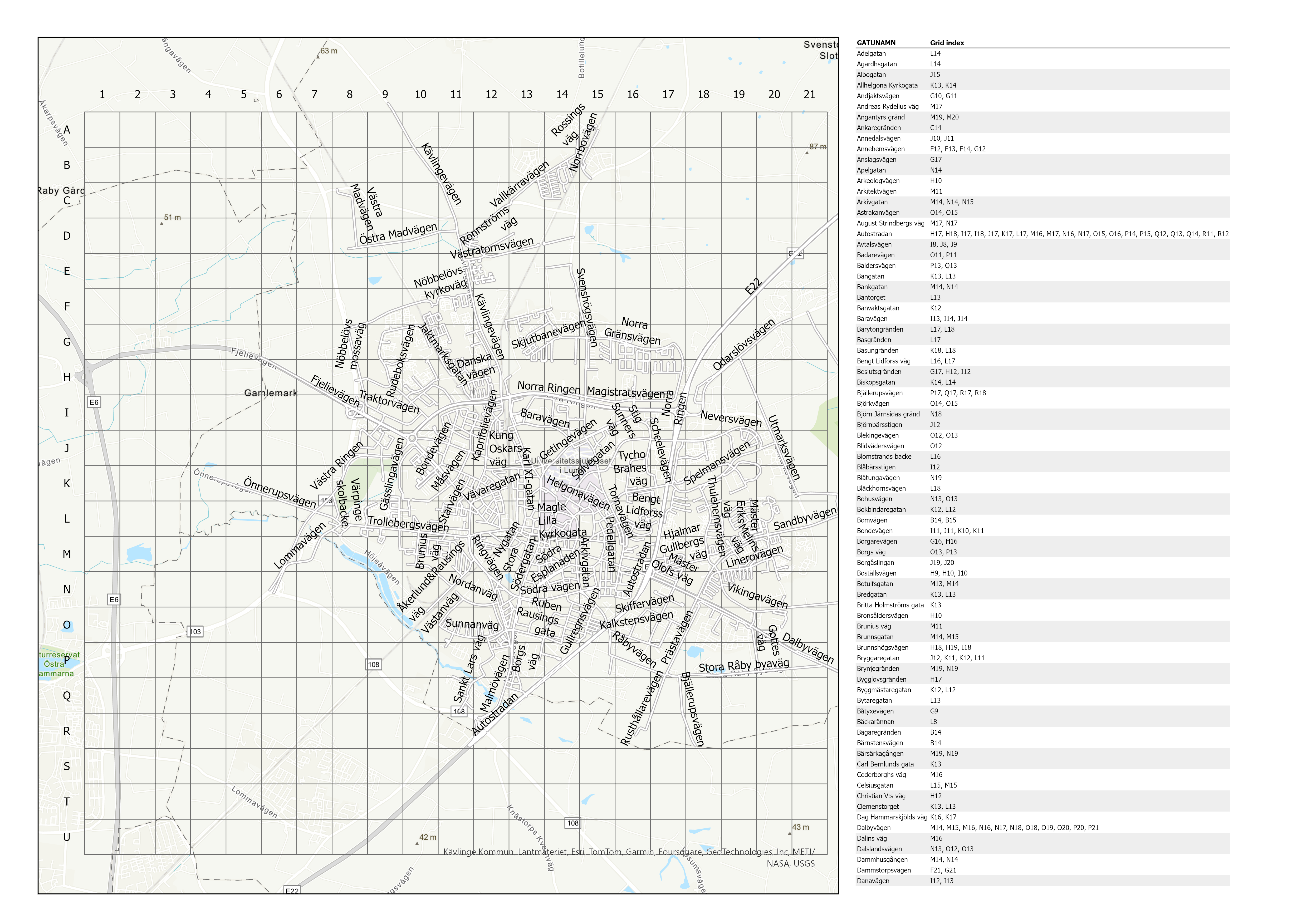

I needed to do the same thing at work yesterday and I developed a workflow that seems to work fine and can be updated quite easily if needed (new roads or expanded area of interest etc).
It only requires some Arcade code, which I will include later.
The tricky part is to create a proper grid. So, when you use the Grid index features GT, don't use the feature class containing the streets as input. Here's what I did:
1. Create a temporary polygon feature class in the same coordinate system as your datasets. In that feature class, add a rectangle that covers your streets feature class. Draw the rectangle's lower left and upper right corners on round coordinates in your coordinate system (e.g. 380 000, 6 170 000 etc) so that the grid index features also create a grid on round segments based on your prefered settings later.
2. Run the Grid index features GT with your temporary layer from step 1 as input and settings as you see fit. Of course you can omit step 1, by defining the origo for the Grid index features tool if you want.
3. Once your grid feature class is created, make a copy of the outer rows and columns of the grid and place them one place away from the grid. These columns and rows will be labelled later and function as a reference grid when you layout the map. Add two fields, one for vertical label and one for horizontal label and populate with with the field calculator so that they only contain letters or numbers from the field PageName in the grid feature class. This is an easy process, I won't write the steps to do it. Then add two label classes, one for vertical and one for horizontal, write a short SQL-expression to only label the required features and lastly change the symbology, so that the labeled features are invisible and the grid features only have an outline.

So, this should populate the field with the indices of every grid box that each street goes through. From that point on, you should be able to export the attribute table to excel, format it and add it to your layout.
I even attach a very ugly layout export, as proof of concept. I haven't formatted the table and the map is a mess, but I am only showing the result of the above workflow, nothing more.
Hit me up if anything is unclear, I will try to answer as fast as I can.
