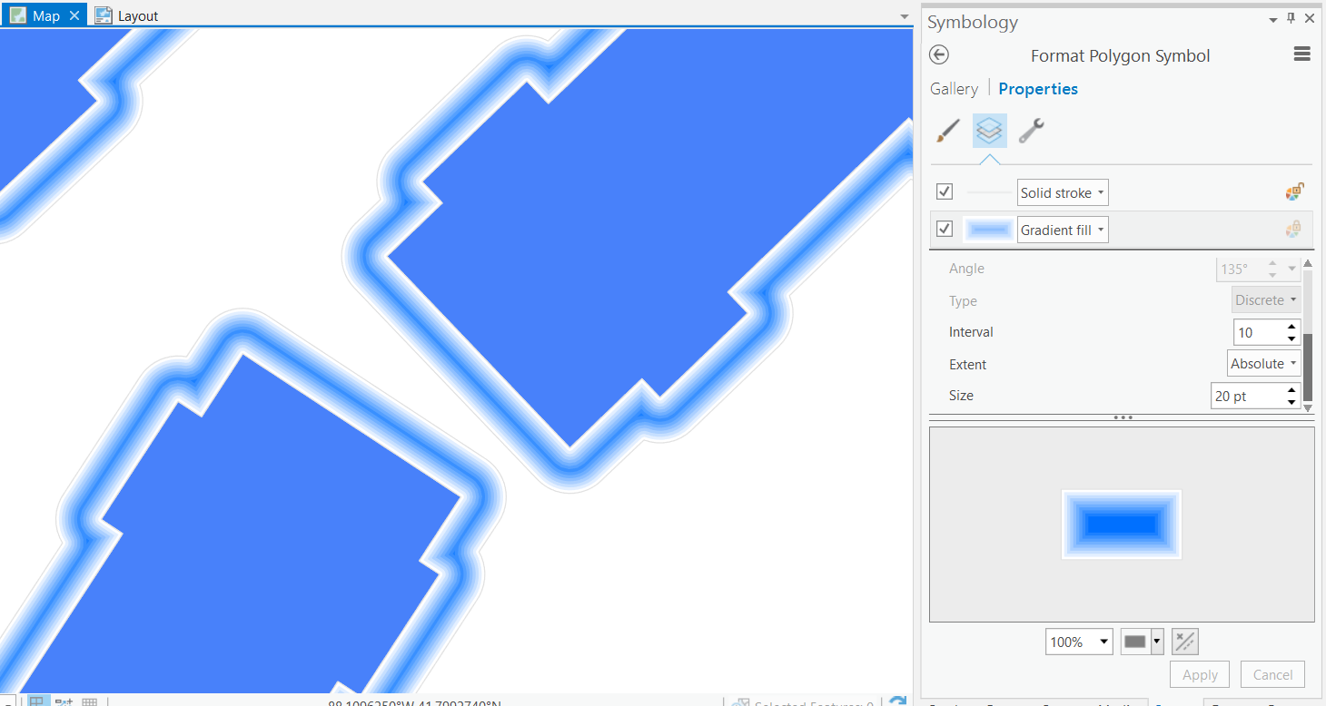

SarahWigley
Thanks, that's a useful suggestion (you can also do gradient fills in ArcMap), which I hadn't thought of.  However, I want to have the gradient colours go from transparent (close to the polygon) to white (further away from the polygon).  This way, I get a nice faded edge showing the basemap underneath fade out to nothing.  I tried changing the blue in the screenshot below to 'no colour' but it doesn't work (just shows as white).  Any thoughts?  With the multiple buffer rings, I used to add a field that contained transparency values, which I used to alter the transparency of each of the rings.

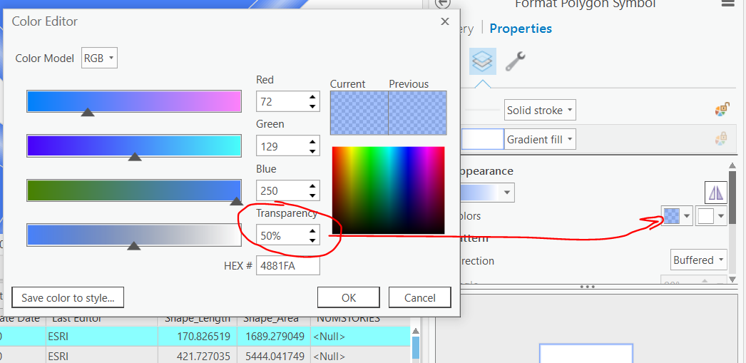

KoryKramer
Esri Esteemed Contributor
You could give that blue some transparency by clicking its dropdown arrow > Color Properties to open the Color Editor and setting transparency:
Maybe that will help.

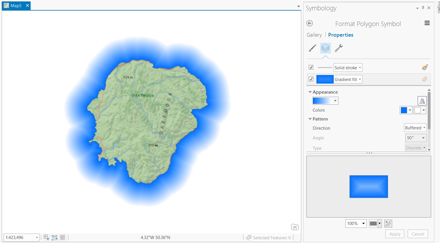

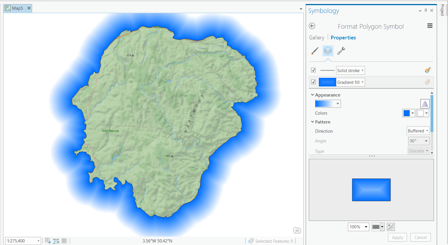

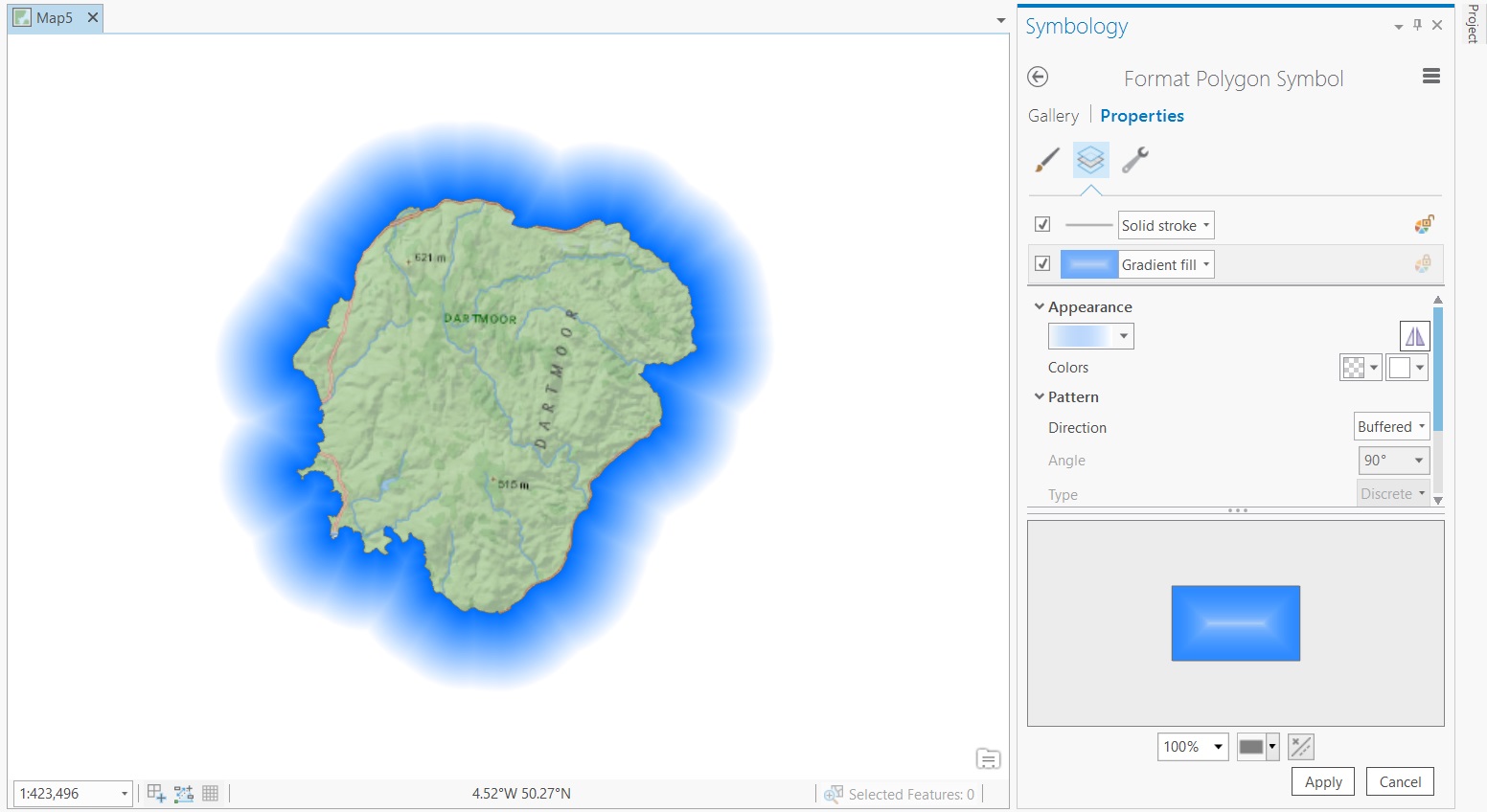

SarahWigley
Ooh I didn't realise you could change transparency of individual colours in ArcGIS Pro (great feature!).  However, it still doesn't seem to work for gradient fills - unless I'm missing something?  The colour changes in the preview icon, but on the map it stays the same (i.e. as if it was 0% transparent).  See below, first screenshot the blue has 0% transparency, second screenshot the blue has 100% transparency.  I've tried with 50% or 90%, etc, but nothing changes it.
