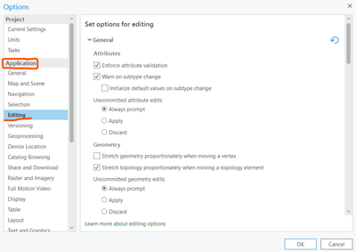

It sounds like what you are after would be setting snapping options at the application level > editing settings:
...which would be a new idea - I searched and don't see a request for that...
ChristopherBowering
Kory - Yes, I believe it would be a setting at the application level.  This is how it is in ArcMap; if you enable/disable the snap tips within the snapping settings under the editing toolbar, that is how it remains for any subsequent .mxd unless you change it again.  I can create an idea for this.
