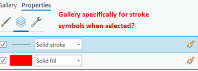

When editing the appearance of embedded symbology (e.g. leader lines, marker symbols on a line), please let us apply styles from the gallery.
Ideally we'd be able to apply a gallery style to any symbol layer, but I understand that would get messy with, for example, applying a border to a polygon symbol. I would be happy if at least being able to apply the gallery styles to embedded symbology.
Formatting a leading line for a callout label
Let me make the leader look like an interstate without doing it manually.

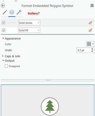

Formatting the polygon in a point symbol
Bonus: Applying gallery symbol to any symbol layer

Applying a symbol layer from an existing symbol to a different symbol
This is a bit different than how you are thinking about it. In your example, you have a stroke and a fill layer in a symbol. What we added in the ArcGIS Pro 3.1 release is the ability to grab one or more symbol layers (of any type-- marker, stroke, fill) from a symbol in a style and add them to the current symbol. So it's not choosing a different symbol for the solid stroke in your example. It would be adding a new stroke symbol layer to that symbol. In this case, you'd probably delete the first stroke layer.
  1. Format Symbol pane > Properties tab> Structure tab
  2. Layers heading > Add symbol layer > Import layers from a symbol
  3. Pick a symbol from the gallery. Change the symbol type at the top of the dialog box if necessary. See Symbol structure—ArcGIS Pro | Documentation
