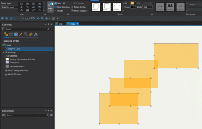

KoryKramer
Hold Ctrl and click on an individual element to unselect it without having to unselect all and start over again.
 Holding Shift and clicking should add to selection. Holding Ctrl and clicking should remove from selection.
