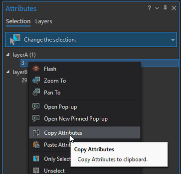

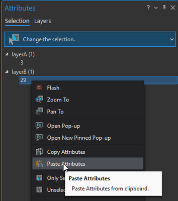

P.S. This may help (depending on the problem), but the Attributes pane’s Copy Attributes and Paste Attributes commands will respect the current Field Mapping settings between layers. So that would be one way to select features in multiple layers and copy and paste specific attributes between them:

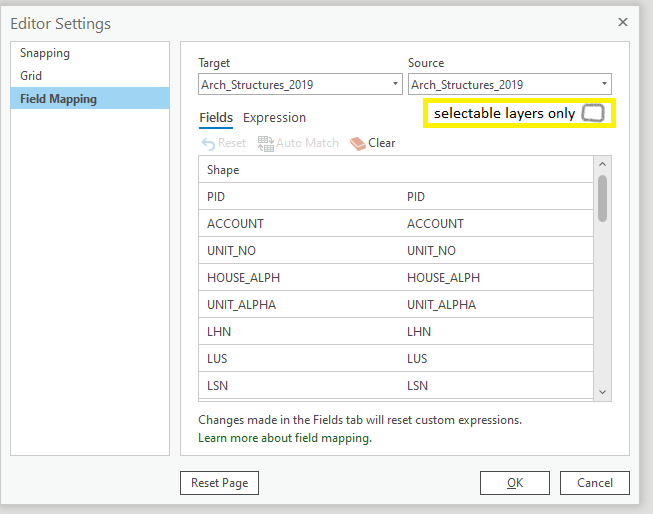

@RichardFairhurstIt isn't a huge help; and I guess I was thinking of ways of limiting a very long list of layers in the Source/Target drop downs.  And this toggle switch would just limited the drop downs to Selectable layers.
Something like this:

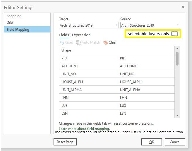

At minimum an additional comment at the bottom of the setup screen should be included that reads something like: "The Layers mapped should be selectable under the List By Selection Contents button"  This would give my users a clue about why the tool doesn't work, since if they do try to do any troubleshooting, they usually check their field mapping settings and would see this essential comment about the tool's behavior and where they should look to fix it.
