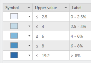

I have this symbology, representing a percentage - this is what it should look like in the legend:
Here is what it looks like after I have typed the Label just how I want, in the symbology configuration pane:

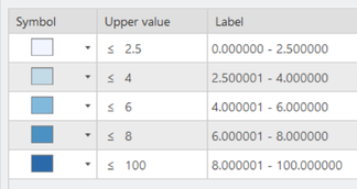

I realized the 19.2 Upper Value (which was inherited from another feature class whose symbology I imported for this feature class) meant that a couple features with higher values than this were not being symbolized on the map.  When I changed the highest upper value from 19.2 to 100, all the labels regenerated to this:
Dang.
My idea is that Pro doesn't need to eliminate this capability to automatically regenerate the labels.  Just have a button or checkbox, right there in the symbology pane, that would give me the choice to opt out.
