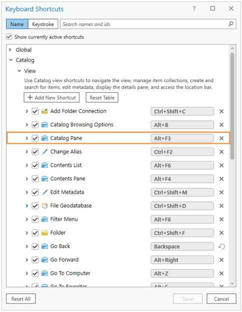

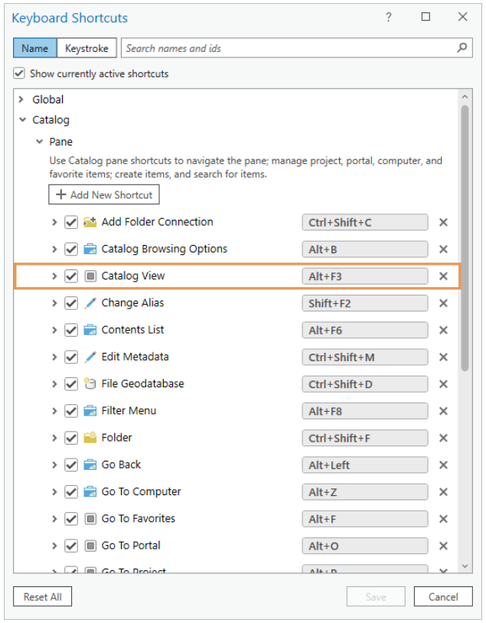

Hello @IlkaIllers1 and everyone,
Thank you for your feedback.  As @TimOrmsby mentioned earlier, the main idea in this thread was implemented in ArcGIS Pro in 3.1, allowing easy switching between the Catalog pane and Catalog view as well as opening the catalog window that was closed, with the keyboard shortcut Alt+F3.  In ArcGIS Pro 3.2, you can also open the Keyboard Shortcuts dialog (with a project open, type F12 to bring up this dialog), where you can see Alt+F3 defined for this function:
Using this dialog, you also have the option to define your own keyboard shortcut for this function - click the keystroke field for this function, and type the key(s) you prefer for this function, and click Save.
