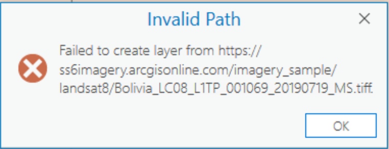

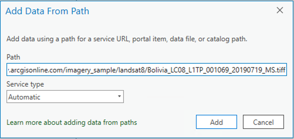

Allow users to add rasters by URL in ArcGIS Pro. We have S3 buckets of imagery (cloud optimized GeoTIFFs) that are exposed over https. We aren't able to give someone the URL to the raster and have them add the layer directly. Instead, they have to create a cloud storage connection and the browse to it. It would be convenient to be able to add http/s accessible COGs directly, e.g. add this example COG as a map layer using only its URL.
https://ss6imagery.arcgisonline.com/imagery_sample/landsat8/Bolivia_LC08_L1TP_001069_20190719_MS.tif...
Adding URL to rasterAdding URL to rasterUnable to add since it's not a serviceUnable to add since it's not a service

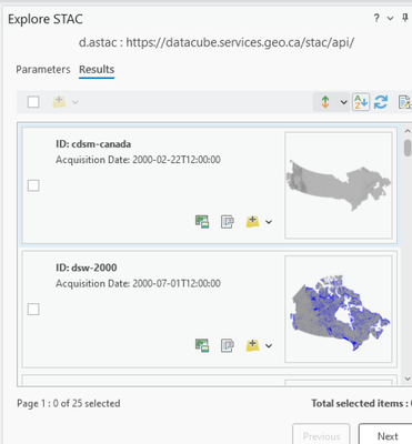

@SimonSchütte_ctSeems a bit buggy? Or maybe Canada's STAC are using a different version syntax. Either way, below STAC didn't work for me and the Add_Cog.pyt did. I leave it for someone else to troubleshoot this time. 😉

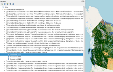

@MattWilkie3 that STAC works well for me in QGIS. I had to change the endpoint to just "https://datacube.services.geo.ca/stac/api/", not the full url listed in the link you posted (https://datacube.services.geo.ca/stac/api/search?collections=mrdem-30).  I haven't tried in ArcGIS Pro though.

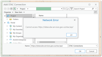

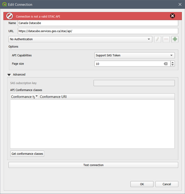

huh, thanks for pointing out the url change needed. Doesn't work for me in Qgis or Pro though. Pro says "Network Error: cannot acesss ..." and Qgis is "Connections is not a valid STAC API". Might be our corporate firewall? It's a bit zealously tuned. Browser visit is fine though.
