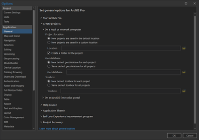

If you are looking to point all new projects to a single default gdb, and atbx location, these settings can be configured in the backstage.
