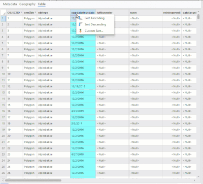

Working with a local file geodatabase table of 3,036,300 records, sorting in Pro takes around 5ish seconds. Here is the gif, no speeding up during processing:

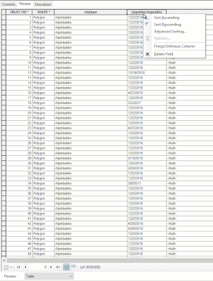

Sorting the same table, same data location, in ArcCatalog takes 1 minute 41 seconds while Catalog shows (Not Responding). You can't see the spinner in the .gif, but if you wait for 1:41 you'll see the table sort.
This one falls into #4 of the pre-submission considerations for ideas: https://community.esri.com/t5/community-help-documents/arcgis-ideas-submission-guidelines-and-status...
