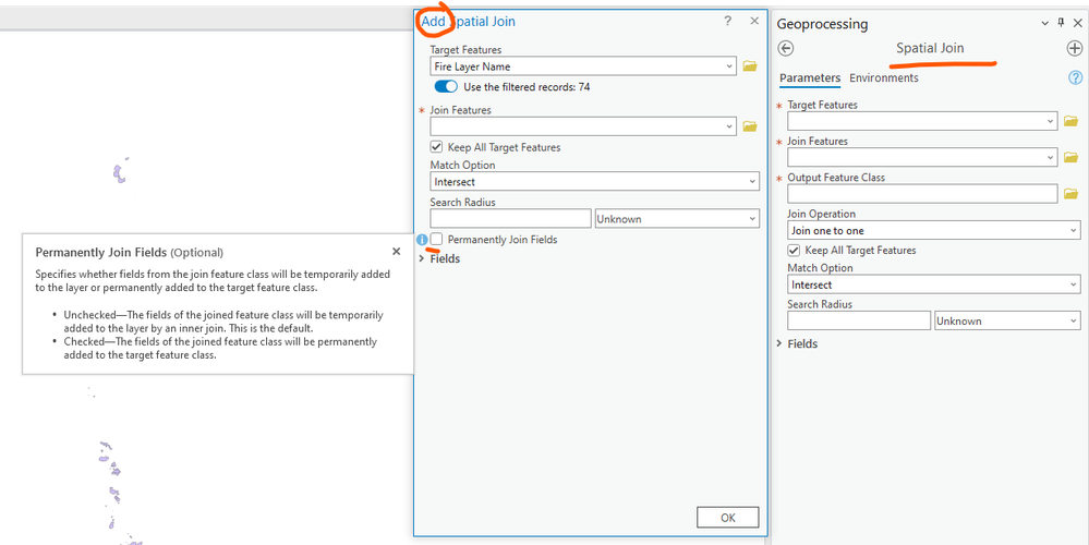

@KoryKramer I'm using 3.1.1. So...I'm going against hundreds of people here. But I always need a new feature class after I do the spatial join. So now I have to right click to Data - Export Features. Then I have to remember to go back and right click and Joins - Remove All Joins. I almost made several mistakes because I didn't remember I already had a join on certain feature classes. This is constant housekeeping in the application when it used to be a simple tool.
What is the best work around for me here? Any chance we can leave this functionality as a choice for the user in Settings somewhere in future releases?!
KoryKramer
If you always want a new, separate feature class, then you could run the Spatial Join tool.
The right-click option runs the Add Spatial Join tool which is the new tool, and creates the in-memory join. Coming in Pro 3.2 later this year a parameter will be added asking whether you want to permanently join those fields to the target.
Maybe that will work well for you? If not, run the Spatial Join tool to create an entirely new feature class.

@drWood There is no control over this intermediate output location and the only work around would be explicitly deleting the feature class after removing the join. You might be interested in the “Permanently join fields” option if you just want to bring in fields from a bunch of different datasets in an iterative workflow.
Our initial development was using a memory implementation for Add Spatial Join, but because memory classes are cleared per session and there is no persistence story cross-session, it was resulting in corrupted joins if you would run Add Spatial Join, close the app, and reopen. So unfortunately until memory persistence is supported, we have the intermediate data in the project geodatabase.
