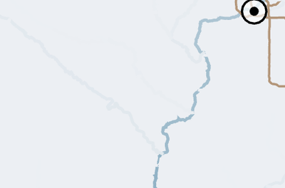

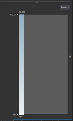

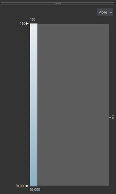

To more accurately show confluences of rivers symbolized by their drainage, I want rivers with higher flows to draw above those with lower flows while using unclassed color symbology. No matter what I do in terms of reversing values & color schemes, the map still draws with lower values above higher values. This looks pretty bad. The symbol layer drawing option is entirely disabled for unclassed color symbology, and there seems to be no way to tell the software the order in which different features within the layer should be drawn.
In both cases, the lower values draw on top of higher ones. Even if I flip-flop my colors so that 150 is darker, the darker then draws on top.
Knowing that it seems to draw lower numbers above, I settled on using the Arcade expression <1/$feature.FIELD> to get things looking better, but my values are nonsensical and I had trouble getting the max/min where I wanted them - seems to be some kind of limit with the tiny numbers. Even if it did work well, it would work for symbology only and not a legend. It would be much nicer to have an option to set the drawing order.
Eventually I got it looking alright with that expression, with line weight also varying by attribute now:
