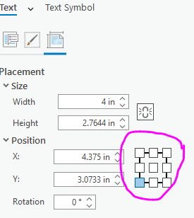

I would like to be able to specify where a leader line connects to the text it's coming from by using the points on the bounding text box. This could be an option in the Callout section of Format Text Symbol properties, similar to how you can specify an anchor point on a text element in a layout.
