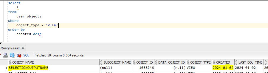

I was able to determine what the view is called by querying the database using SQL to get a list of views and sort by creation date:
The view is called SELECTIONOUTPUTNAME.

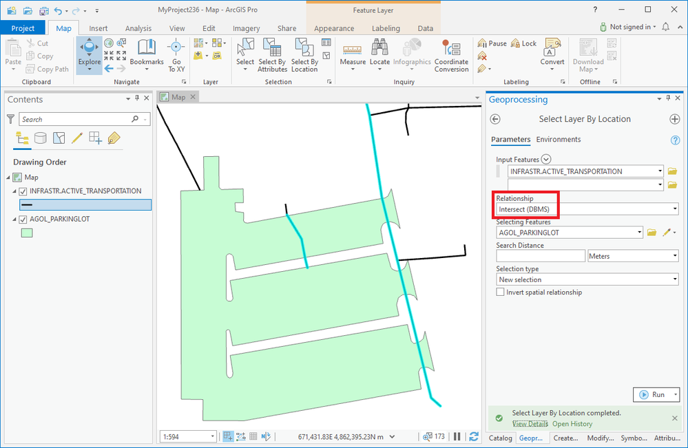

The GP tool settings that I used:
(the AGOL_PARKINGLOT layer isn't actually in AGOL; it's in SDE, just like the ACTIVE_TRANSPORTATION layer)

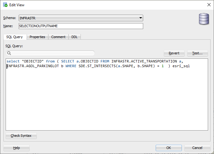

The output database view:
select "OBJECTID" from ( SELECT a.OBJECTID FROM INFRASTR.ACTIVE_TRANSPORTATION a,
INFRASTR.AGOL_PARKINGLOT b WHERE SDE.ST_INTERSECTS(a.SHAPE, b.SHAPE) = 1 ) esri_sql
