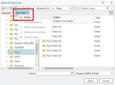

Hello @bdewitt_olsson , do these steps work for you ?
From Save Project As > select a folder > from New Item select Folder > a new sub-folder is created > select that folder > enter a Name & Save.
bdewitt_olsson
Yes, of course those steps work. My point is the Save As process should look and feel the same as the process of creating a new project to provide consistency to the end user. Currently, when using the Save As option, it's unclear whether or not a new folder will be created automatically to house the aprx. This occurred to me as a need because I'm part of a team that oversees a few hundred Pro users, and inconsistencies like this make it very difficult to encourage proper content management.
