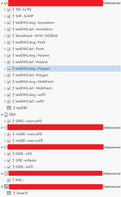

I've been running into this problem recently.
In short, using the Exclamation point to fix broken links has limited functionality.
TLDR: the Exclamation point will repair Esri data types (except mobile geodatabases) + and maybe one thing else, even if everything is in the same folder.
This is not a problem if using the catalog pane to update a map's sources with a find/replace.

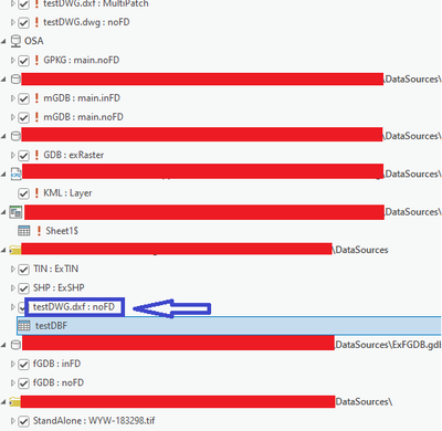

In the screenshot below, I have several layers and views pointing to data of the following types:
  • TINs
  • File Geodatabase Vector and Tabular Data
  • Mobile Geodatabase Vector Data
  • CAD data
  • Excel Data
  • Shapefiles
  • KMLs

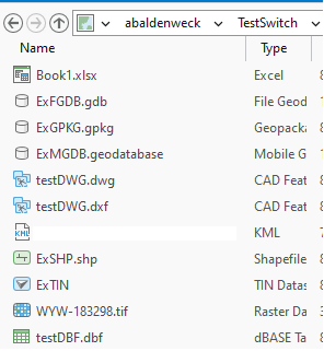

Here's the thing. All of these data sources, as you can see, are in the same folder.AlfredBaldenweck_15-1734391581718.pngAlfredBaldenweck_15-1734391581718.png

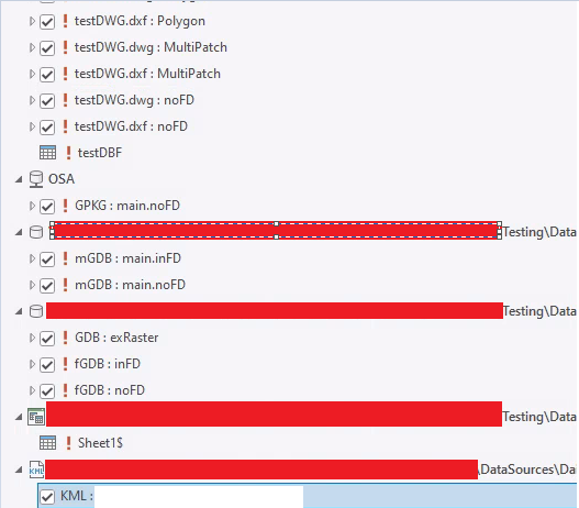

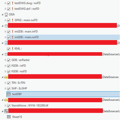

If I use the exclamation point to repair the sources, I get the following results:
Note: I am starting from a fresh map each time.
Thing repairedYieldPicture for proof
DBF or SHP or TIN or file Geodatabase Contents or standalone rasters
  • SHP,
  • TIN,
  • DBF,
  • Standalone raster datasets
  • File Geodatabase feature classes and tables
  • Also caused graphical bug where the broken file geodatabase persisted despite having nothing pointing to it.

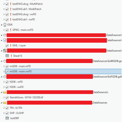

CAD data
  • SHP,
  • TIN,
  • DBF,
  • And exactly one repaired CAD layer, even though there are 10 others in the same place

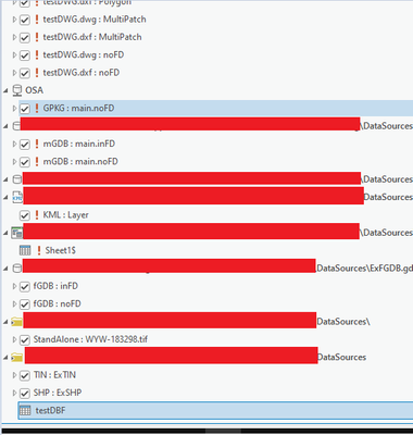

Mobile geodatabase
  • SHP,
  • TIN,
  • DBF,
  • Mobile Geodatabase contents
Geopackage
  • SHP,
  • TIN,
  • DBF,
  • Geopackage contents
  • Also mistakenly repaired the link for layer pointing to a feature class of the same name in a mobile geodatabase

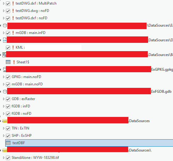

KML
  • Repaired that KML and nothing else
Excel Sheet
  • SHP,
  • TIN,
  • DBF,
  • That Excel sheet
