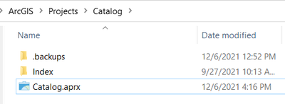

I'm sorry that you had to re-do work.  As a workaround, couldn't you use the Save As a new project option that you mentioned in the idea's opening description?
Save the copy into the original project's same folder with project_new.  Then either delete the first project (or rename that project_old) and update the copy's name to project.aprx.
For example, here is the project copy after I've deleted the original (outdated) aprx.
After removing _new I have the original structure and naming and have kept any changes that were made in the Read-Only copy rather than having to re-do those.
The idea is valid, but I wanted to share this as a workaround that might help.
wayfaringrob
@KoryKramer  I'll have to remember that workaround for next time (though I'm hoping I don't have a next time!). If I were using ArcMap, I would have that without question. The structure of a Pro project, files and all (and my lack of knowledge about all the nuts and bolts), had me scared that that would break something. In other words, I didn't know that was possible without a total renaming/reconnecting.
