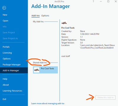

Hi all,

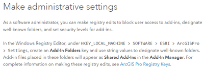

I just talked through this with a colleague and I'd like to get some feedback on the following. The Make administrative settings part of the add-in documentation discusses how to distribute add-ins in the manner that you're referring to.

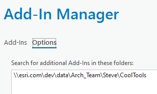

If I only set up a well known folder from a shared network location (my understanding from the original idea and ensuing discussion is this is how you're all setting up your add-ins):
Then we get the behavior described; i.e. the add-in is recognized under "My Add-Ins" and the user has the ability to delete it.
However, if I follow the instructions referenced above to make the add-in available through the admin workflow, it is recognized under "Shared Add-Ins" and the user is not able to delete it.
Hopefully this will help many if not all of you. Does this method work for your organizations? If not, can you let us know why not?

The admin method- Every pc that will load these addins will need to have this registry edited? I don't think this is a viable solution for several reasons.
1. We'd have to track this to ensure that one doesn't slip through a crack; and all it takes is one. PC rebuilds, new installs, personnel moving, does this key persist across version updates, or would it need to be set again, (like how the conda environments used to be).  ... It's not making the installation and management of the software product easier.
2. Lets say the addin is mysteriously deleted.  That means either one pc isn't keyed, or it was deleted from the folder- There is no way we can tell.  I am now spending hours++ checking every pc for this key and the damage is already done.  As much time and effort we put into keying every pc, it didn't prevent it from being deleted but still required more time and management.
3. Changing the folder permissions seems like a more stable (one point of contact) solution since it is done once on the folder, and not on every pc that is running Pro addins. But it is still modifying the system in response to a bad functionality of a program...
4. Using the same folder permissions vs. every pc point of failure- esri can solve this issue for every single one of their users by changing the functionality of that button to just remove it from the user configuration and not delete it from disk. They can solve this issue without their users needing to maintain additional folder permissions or per pc registry edits.
