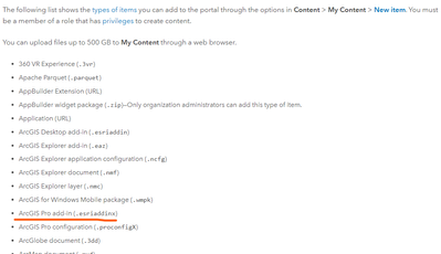

I was looking at alternatives and going the sharing route for deploying these add-ins and see that we can 'share' our add-in to AGOL- but nothing about sharing it our Portal. I don't need to share it to the world, just to our organization. I was hoping that going the shared route would stop the deleting of the .esriAddinX and make it easier for me to manage. @KoryKramer Do you know if there are plans for supporting add-ins in Portal?
KoryKramer
