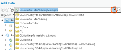

@NathanHeickLACSD
Does this work for you?
This is described in What's new in ArcGIS Pro 2.8 https://pro.arcgis.com/en/pro-app/latest/get-started/whats-new-in-arcgis-pro.htm#ESRI_SECTION1_34757...
It sounds like that is what you're looking for.  Please confirm.

Hi Kory,
It's nice to know there is a history on that pulldown menu, however, I would never have thought that it was there.  After testing Windows Explorer, it matches that behavior.
I was asking more for it to open to the same folder you had open when you closed the dialog the last time.  So for example, if I add a feature class from Zion.gdb, it would open up to Zion.gdb the next time I click on Add Data.
After doing more testing, it does work sometimes.  I have tried it several times and sometimes it works the way I want it to and sometimes it opens on the Projects folder.
