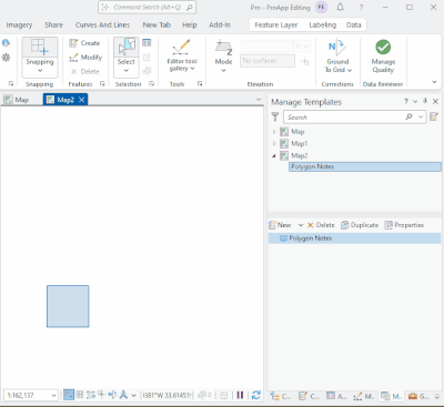

Scott_Harris
@DavidCakalic
Try creating a Preset Template, which allows you to create the same feature (or group of features) with the same anchor point location:
Help: https://pro.arcgis.com/en/pro-app/latest/help/editing/create-a-preset-template.htm
