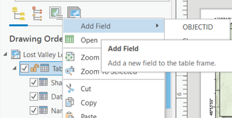

JeffBarrette
Would the experience we currently have with Table Frames be helpful? Instead, Add Layer might have a pull-right that lists all the layers not in the legend.
 Your idea to also have a context menu on a layer to add it to a legend is different but may be possible.  I understand that dragging can be difficult especially if you have many maps / layers.
