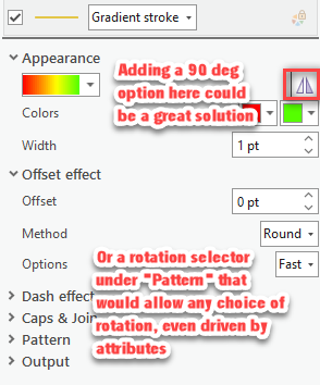

LarsArneson
@KoryKramer is there any movement on this? It looks like it was moved to "Under Consideration" in 2020 but I'm not sure where to look to check the current status. Adding a 90° rotation button anywhere in the symbology would likely be found by users looking to achieve the effect.
