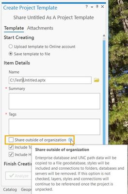

It seems that you were also trying to work around your problem of the server and enterprise geodatabase connections being missing from the project created from your project template.  For these connections to be included in the project, when you create your project template, the option “Share outside of organization” needs to be unchecked in the Create Project Template pane - see https://pro.arcgis.com/en/pro-app/latest/help/projects/create-your-own-project-template.htm :
