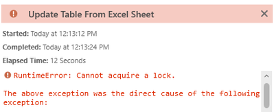

To summarize, I had a tool I was running involving an update cursor, and it kept failing because of a lock on the data.
  1. It was in a file geodatabase on my own hard drive, so no one else had access.
  2. The data was only used in this project, which was the only project I had open.
  3. I was not in an edit session.
I eventually figured out that having the attribute table open constitutes a lock on the data, at least in the context of a Python Toolbox. Closing the table immediately solved the issue.

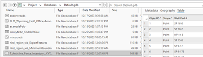

Do you have the same behavior when viewing the Attribute Table via a TOC object versus an attribute table via a Catalog object. When you view it through Catalog you get that little database silo in the tab and the RightClick menu says "Open Table". When you view it via an object in the TOC the RightClick menu says "Attribute Table". Is it possible the Catalog option accesses the database directly where as the TOC option accesses some sort of cache?
RandyCasey
@ScottFedak2085 I have experienced this issue when the Details Panel is open in the Catalog View and the Table tab is active, which is why I keep the Details Panel closed by default. I can confirm, with an Enterprise GDB at least, that when the Table tab is active, it is running a Select Query, which is locking that table, so as far as I can tell, any time a table is being viewed, a Select Query is being ran, especially if you are scrolling up or down on that table. I would not be surprised to find out that ArcGIS Pro does the same thing to FGDBs. My question would be: why would you lock the table for just a Select Query when the table isn't even in a state where edits are even possible? to paraphrase @MErikReedAugusta: ArcGIS Pro just seems to lock tables as a default action regardless of context. This is really inefficient and frustrating.
AlfredBaldenweck
@AllenDailey1  I have manual edit sessions turned on, and I wasn't in one. Also, inside the tool, the cursor is wrapped in an Editor object anyway.
@ScottFedak2085 Just checked, this behavior is still present when opening the table directly from catalog, rather than bringing it into a map. Same thing, closing the table fixes any issues.
Can also confirm @RandyCasey 's issue with running it while viewing the table through the Details of Catalog View. The Geography and Metadata tabs are fine.
