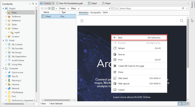

Thank you very much for your feedback.  What you saw is actually a bug that we are working on fixing.  In the meantime, you can use this workaround: when the linked page unexpectedly opened in the metadata view, right click somewhere on that page, and click Back in the context menu that comes up:
This should get you back to the metadata display for the selected item.
