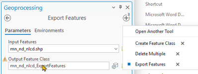

  • click Open Another Tool from the tool you're working on

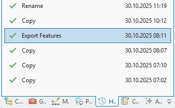

  • open the History pane,
  • dblClick the tool you want to rerun;
  • see it open in the GP pane

  • see it added to the Open Another Tool list,
  • where the tool, you worked on before, is also listed
  • tweak the params
  • rerun
  • from the OpenAnother Tool list, return to the tool you worked on before
In my case, I worked on CreateFC,  clicked Open Another Tool, opened the History tab, dblClicked Export Features,
which opened in the GP pane, ready to tweak params, and rerun. Then, returned from the Open Another Tool to CreateFC, finished param settings there, run it.
