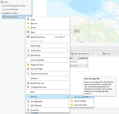

I'm creating a .LYRX layer file by right-clicking the Contents layer >> Sharing >> Save as Layer File:
When using a computer with two screens, the Save Layer File dialog pops up on a different screen than ArcGIS Pro.
When using big screens, I don't always notice that the window has popped up on a different screen.
Screen1: ArcGIS Pro
Screen2: Save Layer File dialog

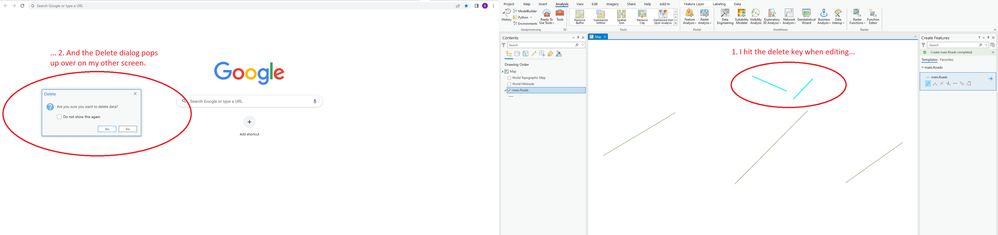

@KoryKramer, the Delete (feature) dialog might be an even better example:
That example throws me off. If I'm intensely working on my right-hand screen, I don't always notice that small dialog popping up on my left-hand screen. The main ArcGIS Pro window is essentially locked while the dialog is open. So sometimes I mistakenly think that Pro has frozen -- which comes off as really frustrating, even though in reality I've just misread what's happening.
