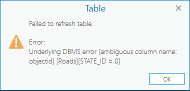

On closer inspection, there's a problem with this approach (ArcGIS Pro 3.0.3; mobile geodatabase).
When I try to create the join on the table with the definition query, I get an error:
Failed to refresh table.
Error:
Underlying DBMS error [ambiguous column name:
objectid] [Roads][STATE_ID = 0]
I tried adding prefixes to all fields in the subquery, but that had no effect on the error:
objectid IN (
     SELECT r2.objectid
       FROM roadinsptable r2
      WHERE r2.asset_id = roadinsptable.asset_id
   ORDER BY r2.date_ DESC, r2.condition DESC
      LIMIT 1
I'm not sure what the cause is.

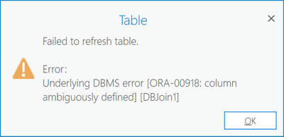

I have the same problem in an Oracle 18c 10.7.1 enterprise gdb (ArcGIS Pro 2.6.8):
Error:
Underlying DBMS error [ORA-00918: column
ambiguously defined] [DBJoin1]
Solved:
I had to add a table prefix (aka "fully qualify the table name") for the objectid in the first line:
Before:
 objectid IN (
After:
 roadinsptable.objectid IN (
I've updated the original queries.
